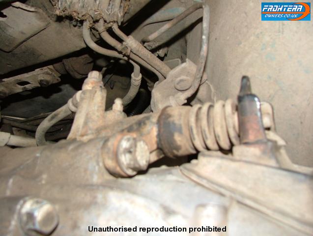

My clutch is slipping under load in 1st and 2nd when you go to accelerate,well it just sorts of kangaroos, hits a flat spot i think :oh yer: so new clutch

Take the gaiter from your clutch slave cylinder and stick a hose in and wash out the bell housing it could be full of crud from deep water, could help the clutch :wink:

:lol: , the rubber thing that goes around the lever that is pushed by the clutch slave cylinder, its on the side of the gearbox the square rubber bit (that doesnt look like rubber in this pic) at the lower right hand corner in this picture, this is taken from below the gaiter looking up from the floor.

Sounds like you pulled the rubber off and the crud has got in, this is why when in deep mud or water you try not to change gears to much as you open the plates (and the rubber) and lets the crud in :wink:

Here's some pictures,am i on the wright wive length :oops:
and clutch pedal pushed down
Re: Mechanic needed in Birmingham/Evesham area by Drift on Wed May 12, 2010 9:02 pm
Yes thats it, the mud can get behind the rubber so peel it back and flush it out :wink:
Remember to fit it back in though.
Has your bell housing got an inspection plate on? I believe some 2.2 petrols have them and they can be missing, this is another point where crud can get into the bell housing.

[quote="Drift"]Yes thats it, the mud can get behind the rubber so peel it back and flush it out :wink:
Has your bell housing got an inspection plate on :dunno:
My clutch did go down at Bala ,i could not get drive,by the time Niel came to rescue me,i got drive,and after that it was fine till now :oops:
Re: Mechanic needed in Birmingham/Evesham area by Drift on Wed May 12, 2010 9:17 pm
Yup, seems you crud in it :lol:
