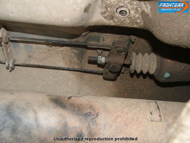

Postby Drift on Fri Feb 19, 2010 6:43 pm
Ahha, this is the cable adjuster.

I then moved on and started to sort out the the handbrake and rear discs. after changing the rear handbrake shoes the new discs would not go on no matter what i tried. i then removed the handbrake cable from the shoes and it went on a piece of cake. I then looked at the handbrake cable in more detail and it was seized. So i have just ordered some new handbrake cables and will have to finish it off on Saturday :(
I was hoping that i would not have to fit new cables :( typical
