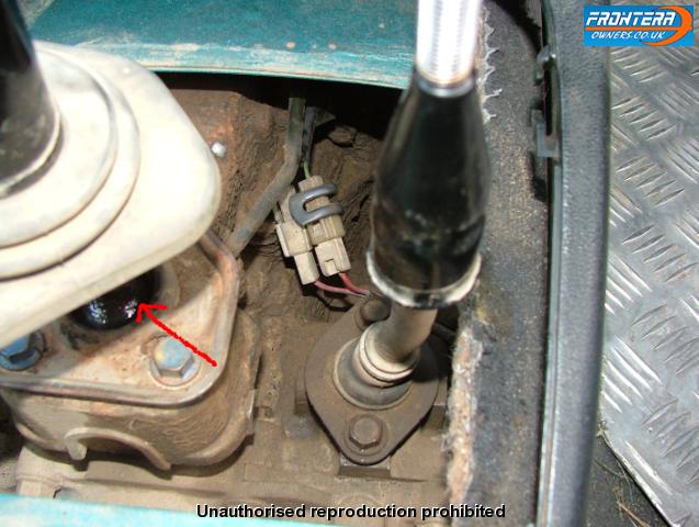

2, The gearbox i have fitted is fine but the gear stick has the wobbles :? can i just change the bushes :?:

There is a little plastic bobble at the bottom of the gear stick, cost about 20p from VX Sir Doris had a few and kindly gave me a one, it took a little movement out of the gear stick but there is a bigger plastic bush in there I think could benefit from being changed as it look rather worn, easy to do and you cant brake anything checking it out.
Take these bolts out and it lifts out,
Oh and well done :dance:

Well I have been to vauxhall today to try and some gear stick bushes to be told the parts are no longer availble :(
can I get the bushes from some where else :?:
Re: At last!!!!!!!!!!!!!!!!!!!!!!!!!!!!!! by Drift on Thu Jan 21, 2010 6:15 pm
See Phil Sir Doris he may be able to get them and post one out :D
Or Isuzu :wink:
Is it the same box?
