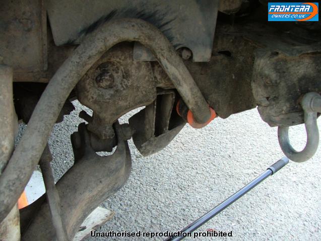

Re: Spanner Party Needed!!! by Trotter on Thu Dec 10, 2009 7:25 pm
Got a fair bit done today :!: :dance: :dance:
Shame every bolt either bent or sheared :( :( :butt:
Anybody got any idea what size bolts for Bumper/Valance and Bullbars :?:

Re: Spanner Party Needed!!! by Drift on Thu Dec 10, 2009 7:49 pm
Looks like you've been busy :D
For the bumper mounts just drill/grind off the captive nuts then fit a new nut and bolt in each hole, will be far easier in the future should you need to remove the bumper :wink:

Ah-Haa!
Might be worth trying to make a template of the holes in chassis rails, transfering to bullbar mounting brackets and drilling accordingly :)
If that doesn't work, leave the buggers off for a while and come up with a plan B :lol:

Re: Spanner Party Needed!!! by Drift on Thu Dec 10, 2009 11:07 pm
Drill the two bolts each side out and replace the one top bolt each side,
With a shackle and you have front recovery points and your bumper will be solid.
