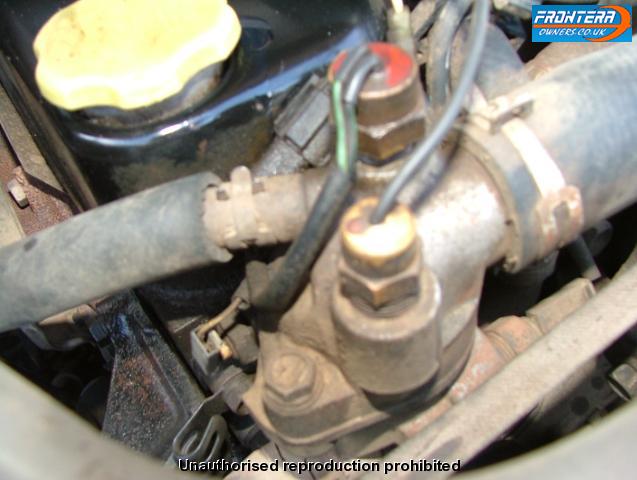

Postby alex on Wed Oct 21, 2009 7:25 pm
Have you changed the right sensor? on the 2.8 its the one on the side of the block, same side as the turbo, just down from the top of the stat. Lots of people swap out the 2 on top ofn the stat, they are part of the quick warm up etc, but not guage.
It has just one wire on it, that could do with a clean up.
its worth dropping the stat out for a day and running without one at all.

Postby Drift on Wed Oct 21, 2009 7:41 pm
Also there are two stats, one is 92° and the other 82° usually stamped on the thermostat itself.
The wires Alex mentioned
Re: how hot does yours run?
Postby alex on Wed Oct 21, 2009 7:49 pm
Cheers Ste, you do have a use, the guage one is just visible down on the left of the photie.

Postby Drift on Wed Oct 21, 2009 7:52 pm
Cheers mate :lol: its the one with the spade connector.

Postby combatcoupe96 on Wed Oct 21, 2009 8:14 pm
thanks all , yeah i changed 2 in the pic , but didnt know their was another one on the block , will have a look tomorrow .
