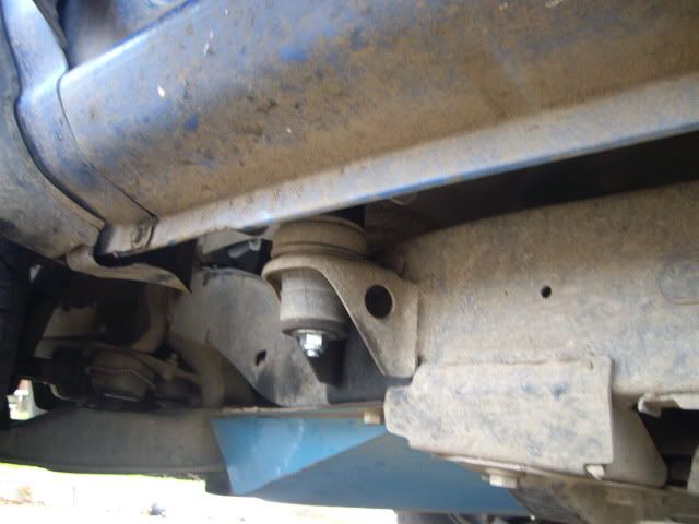

Re: Where do i start. by bobbinsjob on Tue Sep 15, 2009 12:20 am
This is what the 1st plastic would look like
and this is what i made for Angelina
This is where it goes
will look for piccies of the rear plastic plate
Re: Where do i start. by bobbinsjob on Tue Sep 15, 2009 12:33 am
you may be able to make out the blue angular 2nd plate i made from sheet steel
If ever you wanna pop down to Stevenage to have a gander at what can be done to a B series, just give me a shout
