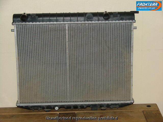

Have you got a picture?
If the two holes are at the top it should be fine.
Does it look like this?
Re: Radiator suitability by Wilberforce on Sun Sep 06, 2009 8:59 am
That looks about right Ste...
Two main hoses, one either side of the rad, with the connection to the expansion tank coming off the driver's side.
Looks like it'll be fine then.

Re: Radiator suitability by Drift on Sun Sep 06, 2009 9:01 am
Well I believe thats from a 20L and its fitted to mine.
Re: Radiator suitability by weave67 on Sun Sep 06, 2009 9:03 am
not sure if the bottems are the same were the cowling mounts one is electric one is viscous (spelling) :?: :?:
Re: Radiator suitability by andysd1 on Sun Sep 06, 2009 9:06 am
all A series radiators are the same, as weave said, on the viscous the lugs for the cowling are round and on electric they are square, but all the lugs on the radiators are the same
Re: Radiator suitability by Wilberforce on Sun Sep 06, 2009 9:14 am
Cheers guys...
I'll take it up then, and see how it goes. The 2.2 had an electric fan, and I believe the later 2.0's did too, so all should be well.

Re: Radiator suitability by stu on Mon Sep 07, 2009 5:07 pm
iv got a 2.0 one in my 2.8 .and its fine . :)
Re: Radiator suitability by Wilberforce on Mon Sep 07, 2009 9:01 pm
Well, Krusher now has a 2.2 one in his motor, and it's fine (or so he said this afternoon, hehe)
