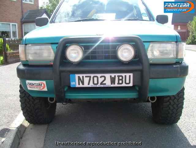

Ive got these on the rear ( as do a few of us )

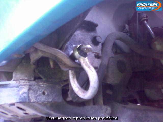

And on the front I took out one of the bumper securing bolts on each side and drilled out the holes big enough to accept a shackle.
Close up.

Thats the approach I was looking for. I'll get some from ebay, however, the recommendation was that they should be weleded onto the chassis.
What is the depth of shackle bolt that I need to be buying. i do not want to get a pair that are too small.
Mark

No need to weld them, they have been tested and are plenty strong :oops: :lol: anyway you may need to remove the bumper one day.
Top of my head think they are about 4" deep
Re: Where to buy Front recovery Shackles by alex on Wed Jan 21, 2009 8:31 pm
Remember the chassis is only 2mm thick steel box. You use a recovery shackle from 15mm diameter steel and its stronger than your car.....
