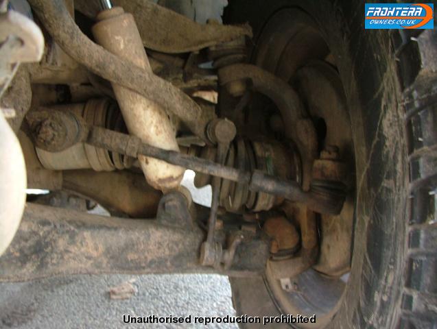

Can someone post a photo of a flipped set up?

Re: Ball joint flips by Drift on Fri Jan 09, 2009 12:20 am
Best I could muster up quickly, will get the write up from planet Isuzu :wink:

Re: Ball joint flips by meooo on Fri Jan 09, 2009 9:32 am
The pictures make it very clear what the problem is
The ball joint is there to support the weight of the vehicle.....all that supports this vehicle is a split pin and a castellated nut!
The danger here is the ball can be pulled out of its cup (seat) and leave you on 3 wheels :(

Re: Ball joint flips by Rifleman on Fri Jan 09, 2009 10:54 am
I dont like the angle of the driveshaft. It looks constantly under strain.
