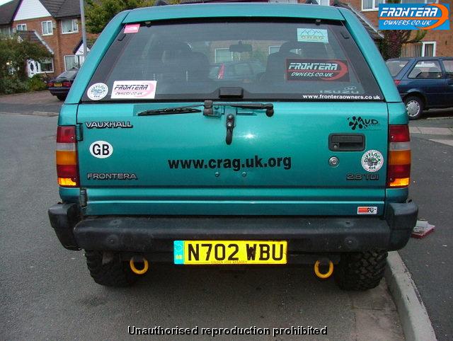

Re: Hi-Lift by Drift on Mon Oct 20, 2008 3:21 pm
Keep the tow bar mounting cross bar, it gives a degree of protection and a jacking point for the rear, and you can also do this.
Grind or take the towing ball bar off though, you will see on the piccy.
