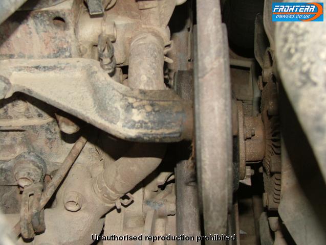

Are you sure its the turbo, it could be the aux belt tensioner, they sound rough when dry, try oiling it see if it changes :wink:
This is the tensioner
Re: turbo by woodwizzard on Sat Sep 20, 2008 3:28 pm
It is deffo the turbo, I can hear it through the snorkel now if I stick my ear to it when I switch off :lol:
Re: turbo by Drift on Sat Sep 20, 2008 3:33 pm
I bet its like mine, just noisy :wink: :lol:
