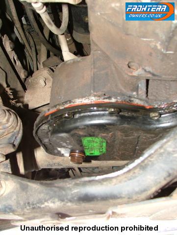

Postby Drift on Sat Apr 02, 2011 8:36 pm
Thats the reason I went for the drain plug, I change the oil every 3k and thats how I ended up stripping the thread on the pan, but on my 2.8 pan the hole for the drain is actually on the raised part of the pan, regular oil changes and filter changes should in theory not allow any build up of crud.
Here is the pan so you can see what I mean :|
See here its situated on the higher section of the pan :shock:
Re: Daddy's not very helpful helper...
Postby snapper on Sun Apr 03, 2011 11:53 am
The sump plug on mine is even worse than drifties as can be seen below. I now jack up the offside of the car when doing oil changes to help get all the oil out.
snapper
Posts: 2189
Postby Drift on Sun Apr 03, 2011 11:58 am
Same place Frank, just my pics didnt show it very well :lol:
That said, yours looks like it has a collar around it :?
