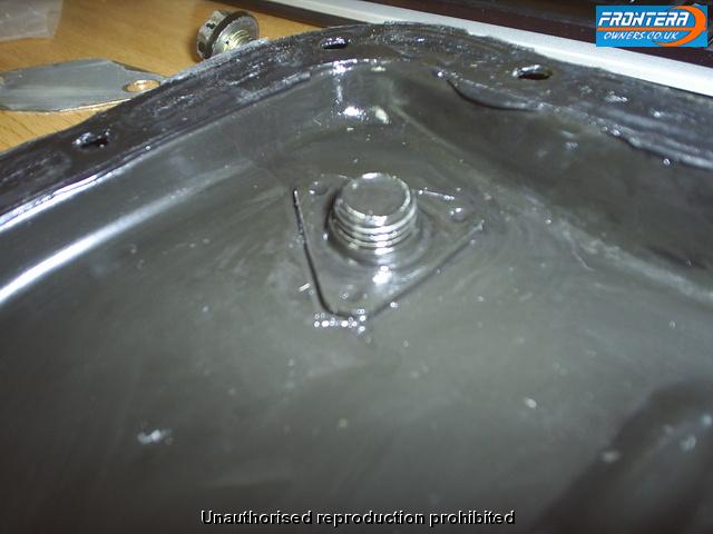

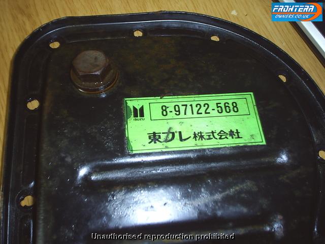

Re: DOH! Stripped Sump Thread. by Drift on Mon Dec 08, 2008 9:57 pm
For those with the 2.8 this is what your dealing with
inside view
Re: DOH! Stripped Sump Thread. by Sir-Doris on Mon Dec 08, 2008 10:18 pm
As you can all see from Ste's pics the pressed steel sump just has a metal collar welded to the sump and it doesnt have much material to work with.
Goo pic Ste.
